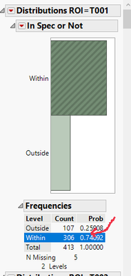

instead of formulas, maybe try using the distribution platform's capability report
first set some specification limits via the column properties
![Screen Shot 2023-02-06 at 3.42.41 PM.png Screen Shot 2023-02-06 at 3.42.41 PM.png](https://community.jmp.com/t5/image/serverpage/image-id/49870i25DC326EFBDA3C78/image-size/medium?v=v2&px=400)
next, just do a histogram on the column, capability happens automatically, and the smallest bit at the bottom has what you might be looking for.
