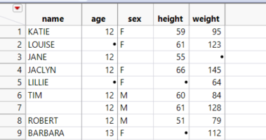

      I am assuming you have a table that looks like this :
  You can script your new formula like so :
If( Is Missing( :name ),0,1) + If( Is Missing( :age ), 0, 1 ) +
 If( Is Missing( :sex ), 0, 1 ) + If( Is Missing( :height ),0,1) +
If( Is Missing( :weight ),0,1)
Best
Uday
Best
Uday
