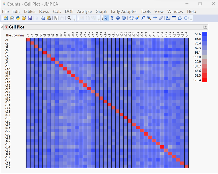

txnelson
Re: Count number instead of dots in scatterplot matrix of binary data
Here is a script that creates a new data table with the counts
Which gives you your scatter plot counts, and it then creates a cell plot which gives you a color map of the values.

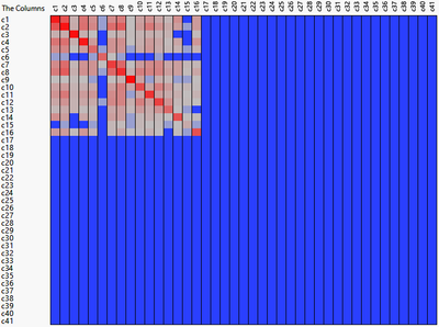

 Many thanks for this!
the new data table with counts makes sense when randomly checking several values.
But somehow the table and corresponding figure stop after column 16, see below.
I see nothing out of the ordinary in the script that I simply copy&pasted (i.e. no extra commas or something that I accidently put in there).
Any suggestion why this could be?

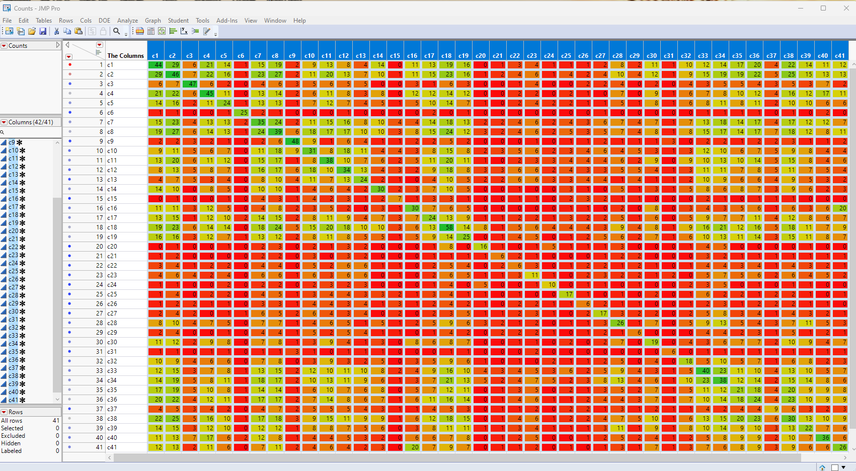

txnelson
I suspect that you are running the script against the wrong data table.
I opened the Excel table you attached, and then clicked on the "Enable Editing" button to permit changing of the table.
I then clicked on the JMP Addin button in Excel and then clicked on the Data Table icon to have Excel create the spreadsheet to a JMP data table.
I then copied the script I wrote from the Community Discussion page, Changed all of the references to "40" to "41".
Next I added in ":c41" to the Cell Plot/
Finally, I ran the script and got the count data table
and the Cell Plot output
The only think I can think of that is causing the issue that you are seeing is that the data table with all 41 columns is not the current "Active Data Table" when you are running the script.
Here is the JSL, with the references  pointing to 41 columns.

txnelson
You do not have to close all of the files to make sure you are pointing to the correct data table.  All you need to do is to click on the data table in question and then run the script.  Clicking on the data table makes it the Current Active Data table.
Also, you can color the cells in the data table to allow the displaying of the colors and the actual data values.  Here is your data in such a display
Jim
