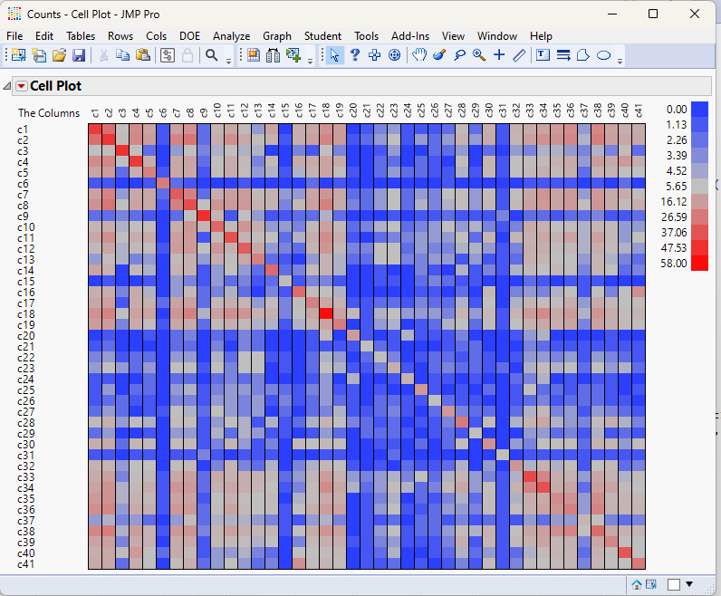

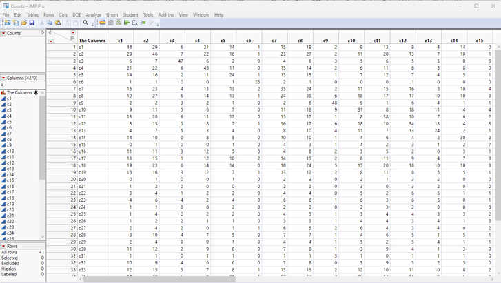

Here is a script that creates a new data table with the counts
Which gives you your scatter plot counts, and it then creates a cell plot which gives you a color map of the values.

the new data table with counts makes sense when randomly checking several values.
But somehow the table and corresponding figure stop after column 16, see below.

Finally, I ran the script and got the count data table
and the Cell Plot output
The only think I can think of that is causing the issue that you are seeing is that the data table with all 41 columns is not the current "Active Data Table" when you are running the script.

Closing all JMP files, importing the file I uploaded here did fix the issue indeed.
Not sure why I had the issue in the first place, as the values for the first several columns did seem spot on...
Thank you so much, although the figure does not contain the actual numbers, the "intermediate" datatable that is generated in the process does so
So now I have both a nice visualization and the actual numbers for reference.
thanks again!
