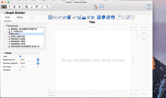

I have a table which consist of few parametrics item that I want to check for correlation with respect to few X items at one time. Can I know what is the best way to do it as per attached file. I would like to have param1 vs param2 and param3 at the same time for correlation check and compare against 2 different Eval, T_Type and No_ID. I think in Graph Builder, I can do that but how about in Analyze section.

After importing your data into JMP change the modeling type of T-Type and No_ID to Ordinal or Nominal and then drag all three of your columns (Eval, No_ID and T-Type) to the X axis in Graph Builder. Then drag your three parameters to the Y axis. You can shift-click on the Line element to add the line.

I'm looking into something like pareto chart whereby my Y-axis will gives me param1/param2/param3 while my X-axis will show me the Eval, No_ID and T-Type. Please refer to example as per attached.

Thanks Jeff and Ian. I guess this is what I'm looking for :)
