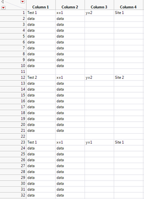

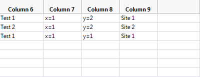

Hi Everyone,
I have a huge file which have many different tests.  It looks like each test was appended to the original csv file.  I would like to copy and paste the cells which contain the header, and put them into a list.  It doesn't matter to me if it is in the same data table or a new one.  I would like to write a script to do this.  All the tests will be evenly spaced.
I can't share the file, but here is a better visual for what I am looking for.
The data:
The result I would like:
Thank you!
