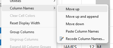

For your approach (with column names in row 1),
you could directly paste the values with column names:
If the data is already in JMP,  "Move Up" is the coolest way to get the column names "up":

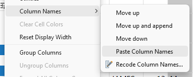

Re: Copy pasting column headers & data from Excel to JMP - changed behaviour in JMP19?
As an alternative, you can use "Paste column names"
from
https://community.jmp.com/t5/Discussions/Undocumented-Secrets/m-p/907821/highlight/true#M106607
