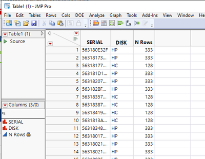

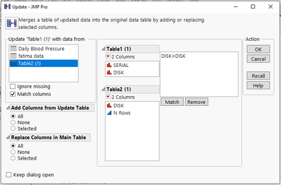

  2. Go to       Tables=>Update   In the Update Dialog Window select the Summary table and to match based upon the column Disk                                             txnelson_0-1652412879897.png
  3. Click on OK and the data from table 2 will be added to the original table                                                                           txnelson_1-1652413086309.png
