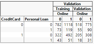

Results in JMP look like:

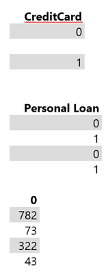

When pasted into Word I get 6 separate tables where each column becomes a separate table. I'm not pasting all of them in the example below. First 3 are:
I have 4 options in Word.
1.Keep source formatting which I have shown.
2.Merge formatting, not shown but looks the same.
3.Picture which I don't want. I want to edit the values
4. Keep text only which again gives me 6 tables but, without any shading.
This used to work easily. Any suggestions? Not sure of what changed.
