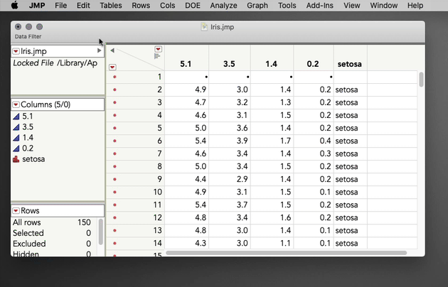

In a few of the files, I've found a lack of first line header info.  So, if I chose to use the first line as a header, the data finds itself as the column names in the jmp data table.  An easy solution to this would be to insert a line, copy in the header line into the first line... but then I'm at a loss as to how to actually copy and paste the header "row"... is there a way to manipulate the headers all together and not select all the columns' rows at the same time?

You can copy the column headers by selecting the columns in the columns list on the left, and then copying with Edit > Copy As Text (not Edit > Copy). Then, select the first row and then Edit > Paste.
In JMP 16 (available 2021) there are built-in utilities for situations like this available under Cols > Column Names >. For earlier versions of JMP, I highly recommend @MikeD_Anderson 'sColumn Name Utilities II Add-In, which adds these same utilities.
So why not Edit > Copy? Edit > Copy returns text in rows, which is useful when you're copying column names from one table to another. Edit > Copy As Text will return a tab delimited list, which is good for this particular case where what you are asking jmp for is the transpose of your columns list.

This can be done, by selecting all of the column headers in the columns panel you want to copy, go to the Edit pull down menu and select Copy. Then go to the data table you want to copy the headers to and select in the column panel, the columns you want to paste into, and then go to Edit=>Paste pull down menu.
