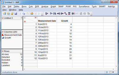

Suppose your data looks like this.  Notice that the Measurement Date column is of text type, and the dates are in the form ddMonYYYY.

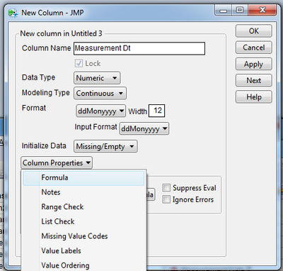

Right click on the empty column header next to the word "Growth" and select "New Column".  Call this column Measurement Dt
Set the format of the data to Date > ddMonYYYY
Click on Column Properties > Formula.
Click on the Edit Formula button
Double click inside the red box that says no formula and enter the following text: informat(:Measurement Date, "ddMonYYYY")
Click OK and the OK again.

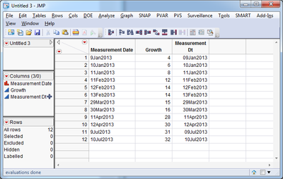

Now your dataset has a numeric column that shows the date you entered in the first column.

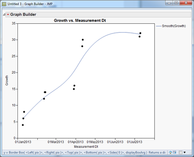

Click on Graph > Graph Builder.  Drag Measurement Dt to the X axis, and Growth to the Y axis.

Thank you! It worked. Although when I try to make a chart instead of using graph builder, it doesn't work (it graphs the dates as categories instead of as a continuous variable.) If you have any advice about how to fix the problem in "chart", I'd appreciate it. However it works great in graph builder and that is a huge step forward for me!
