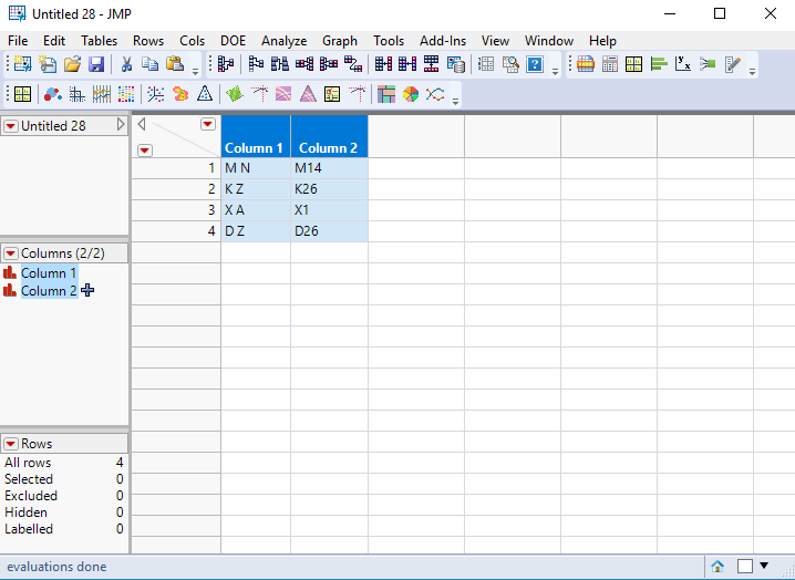

Hi,
Try the following Formula (copy - paste in the Formula Editor)
Word( 1, :Column 1, " " ) || Char(
	Hex To Number( Hex( Word( 2, :Column 1, " " ) ) ) - 64
Here is a snapshot of what the table will look like
Thierry R. Sornasse
