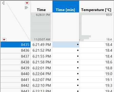

Dear JMP users,
I need to create a column for time in minutes, which correspond to the duration considering the first Date as the starting point).
Dates were given in h:m:s AM/PM.
Do you know which formula I need to use ?
Thanks

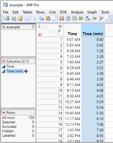

The formula is pretty straight forward
:Time - :Time[1]
I have attached an example data table
Jim

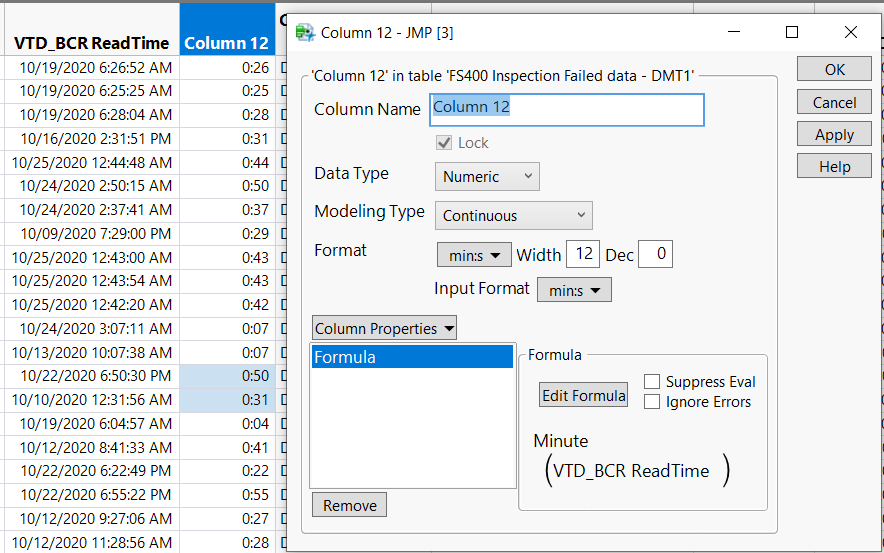

Or you can use MINUTE() keyword to achieve the same result
Thuong Le

@ ThuongLe , Thanks for your answer, however the Formula "minutes" gives you minutes for each corresponding date without converting number of hours into minutes, and also its does not calculate the duration of time.
