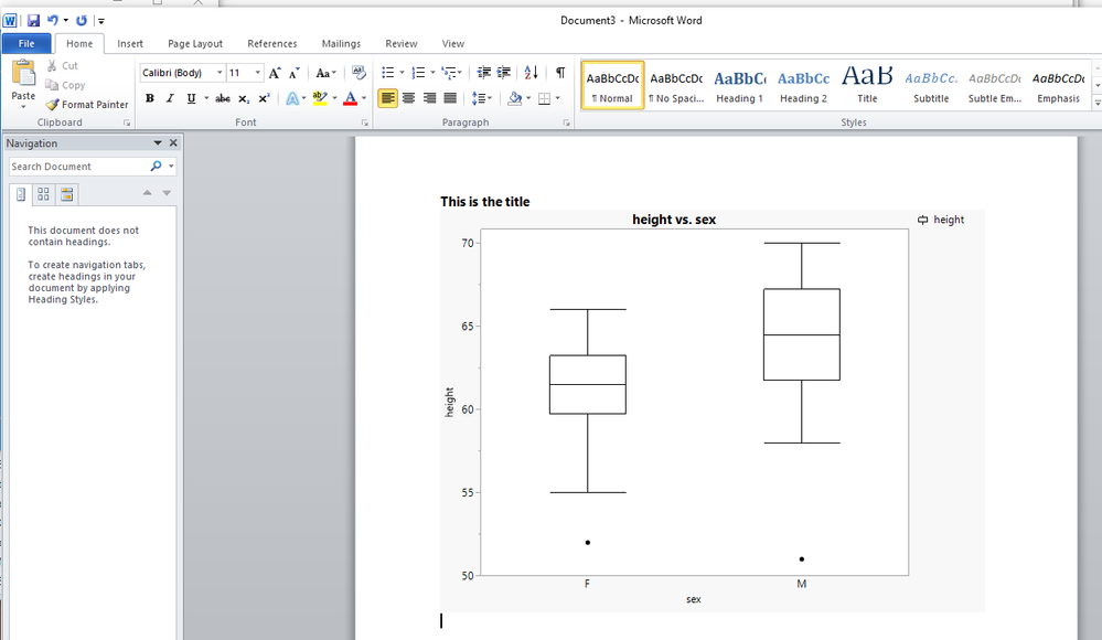

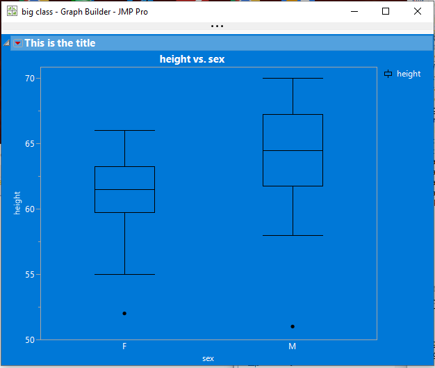

If you include the title in the selection you are making, it will copy it go Word as a title.

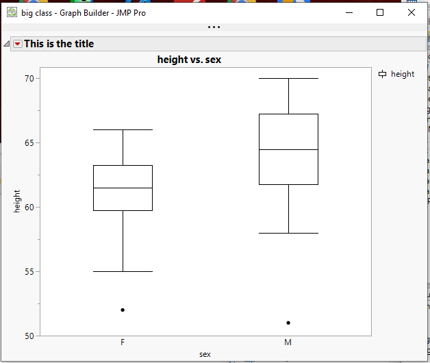

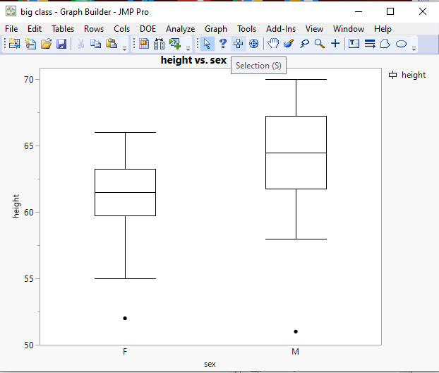

If you go to the tool bar and select the selection tool "+"
You can then click on the title and it will include the title and the complete graph
So when you copy and paste this selected area into a word document it brings the title along as a title

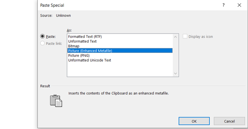

I'd like to add in to Jim's response.
You can actually do further editing if you use Paste Special function in Word after you copy from JMP. Choose Picture (Enhanced Metafile)
If you right click on the picture, you can actually edit it within Word
