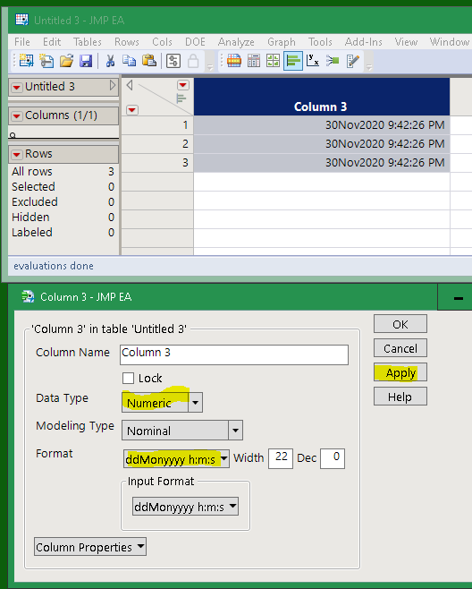

You can interactively make the change. Select the data column. Select Cols > Column Info. Change the Data Type to Numeric. Change the Format to the matching Date format of your character strings. You do not need a new column this way.

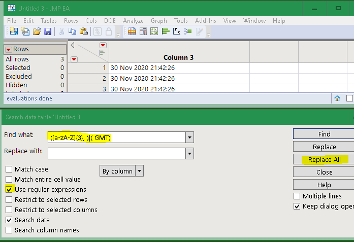

If you use Mark's approach, you'll need to remove the extra bits first. I used a regex in the find/replace dialog:
You have to run it twice. The first time removes the day and the second the GMT.You have to run it twice. The first time removes the day and the second the GMT.
The regex matches three letters followed by a comma and a space, or it matches a space followed by GMT.
Then use
Change DataType *and* Format at the *same* time or you'll get missing values.Change DataType *and* Format at the *same* time or you'll get missing values.
