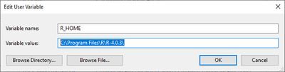

I would verify the following:
  • You have a R_HOME user-defined environment variable setup, pointing to the path where R 4.0.3 lives.
  • Only one version of R is installed on the machine.
If the issue persists, contact Technical Support.

Thanks again for your kind suggestion.
I already add R_HOME in system variables yet the problem still there.
I will contact Technical Support as your suggestion.
