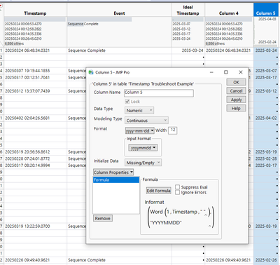

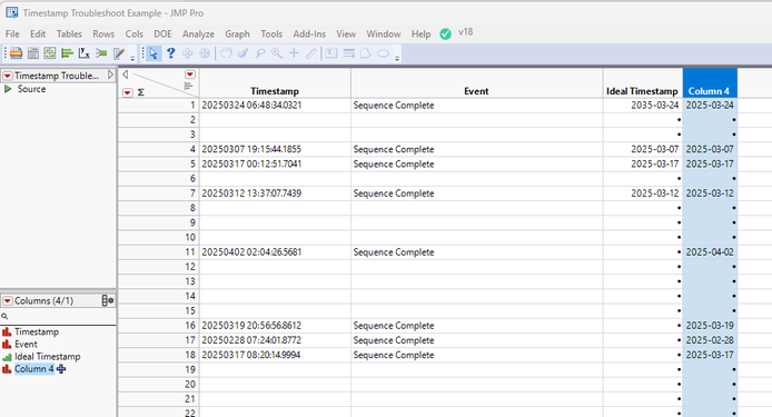

I've read through past discussion posts trying to find a solution to converting a timestamp that is character/nominal into a date that is numeric/ordinal. So far I've tried the following approaches without success:
  • Reimporting the .CSV with numeric/ordinal selected
  • Formula using informat and format
  • Recoding
Does anyone have a formula suggestion that I can use to transform 'Timestamp' into the format identified in 'Ideal Timestamp'?

jthi
Re: Convert Character Timestamp to Numeric Date
Use Word + In Format
In Format(Word(1, :Timestamp, " "), "YYYYMMDD")
You can also try to play around with Format Pattern but it might not work due to milliseconds. If you wish to have the time left, use word with "." separator and modify the format for informat as necessary
-Jarmo
txnelson
Here is one way to handle this.
Create a numeric column and set the format to be displayed to
       yyyy-mm-dd
Then set the columns formula to
Date MDY(
	Num( Substr( :Timestamp, 5, 2 ) ),
	Num( Substr( :Timestamp, 7, 2 ) ),
	Num( Substr( :Timestamp, 1, 4 ) )
Jim
