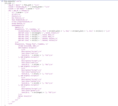

Here's the issue i'm having.
1) Open csv file into jmp data table
2) Create a Oneway Plot from data in jmp_dt
3) Save Oneway plot script inside jmp_dt                  // Having trouble here.
4) Save jmp_dt
At the bottom of this script, I call jmp.run_jsl(jsl_code).
I can save the jmp_dt out to a .jmp file. But I want to Oneway script saved in the jmp_dt when I save it.
Can someone help me with this?

After the Oneway paragraph is completed in your code, att the statemet
obj << Save Script to Data Table(
		"Place name you want here", <<Replace( 0 ), <<Prompt( 0 )
That will add it to the data table and when you save the data table, the script will be saved with it
