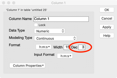

Jeff_Perkinson
Re: Convert Character Date Time to Date Time
As @txnelson says, we could use some more detail and an example but it may be that you just need to specify the number of decimals to display in the format of your column.
