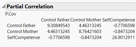

Hi, sorry for the confusion. What I meant is the P-value of the Partial correlation you get when you try to run MANOVA. It doesn't need to be the exact P-value. I just want to know whether the correlation was significant or not. As you see in the image, the result only show the correlation without giving any indication about the significance of the result. :(

The hypothesis tests for the partial correlations are not available at this time. You might contact JMP Technical Support ([email protected]) to see if there is a work-around available. That is, you might be able to determine the p-value from the information given in the MANOVA report.
