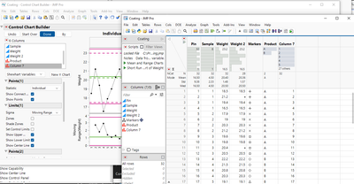

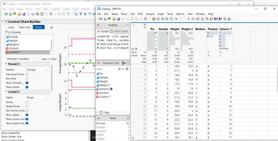

Hi all,
Attached are two control charts but the second one is changing point 1 statistic to average instead of individual when i try to graph it. the data is identical a date and a numerical value. what is even weirder is that i got it to work for one data set but not for another. both data sets are a date and numerical value does anyone have a solution for this?

I have my doubts about your data being identical. If you have groups in your data (multiple values on same date in your case) JMP will use aggregation with control chart builder.
All values unique for Column 7
One "duplicate" value
-Jarmo
Re: Control Chart Builder
The first chart is an "IMR" chart, and the second is an "XBar&R" chart. See: Shewhart Control Charts for Variables.
JMP will default to the XBar type if there is more than one measurement per date, as @jthi pointed out. The rows where Range is nonzero would be an interesting place to spot-check whether the data tables are identical.
