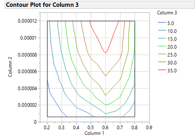

Hi,
I used JMP for a few years and recently got a strange problem during a contour plot. Please see attached JMP file (test.jmp).
The data was plotted correctly in matlab. In the attached file, if I just plotted freq from 0.2 to 0.8, everything looked good (as left image). But if I included freq=0.9, the plot is changed completely (actually, the plot shrunk to a single line, as right image). I also noticed even I didn't add new data, but changed the exist data slightly, the plot was changed completely to a line, i.e. I changed one data freq from 0.8 to 0.9. It's so weird to me.
Can anyone give me a help?
Thanks a lot!
-Lei

DaveLee
Level IV
Re: Contour plot weird problem
I ran the same analysis and extended the x-axis to include 0.9 and got a nice looking plot.  What version of JMP are you using?  I'm using v12.  Perhaps you accidentally rescaled the y axis as well.

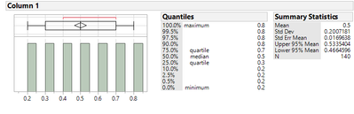

Sorry, I might draw my conclusion too soon. After JMP re-installation, I actually still got the problem. In your plot, the column1 is still from 0.2 to 0.8. Can you please try add 0.9 data and see if you have similar problem?
Thanks,
-Lei
DaveLee
Level IV
Guleiss,
I plotted the data you provided and there is no data >0.8. In my original plot I just manually changed the axis settings.
DaveLee
Level IV
Here's the code to do this in JSL:
Contour Plot(
    X( :Column 1, :Column 2 ),
    Y( :Column 3 ),
    Show Data Points( 0 ),
    Fill Areas( 0 ),
    Label Contours( 0 ),
    Transform( "None" ),
    Specify Contours(
        Min( 5 ),
        Max( 35 ),
        N( 7 ),
        Contour( 1, 5, -2380261 ),
        Contour( 2, 10, -1998002 ),
        Contour( 3, 15, -1285756 ),
        Contour( 4, 20, -58112 ),
        Contour( 5, 25, -7246852 ),
        Contour( 6, 30, -12018696 ),
        Contour( 7, 35, -16125962 )
    SendToReport( Dispatch( {}, "1", ScaleBox, {Max( 0.9 )} ) )

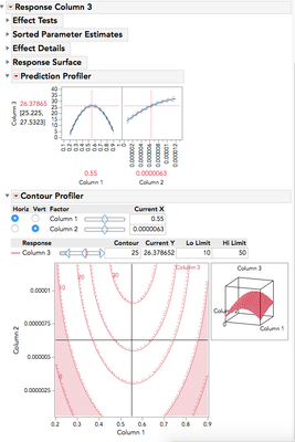

louv
Staff (Retired)
Hi L.
I see the same funny behavior as you do when I un-exclude the 0.9 rows using the Graph>Contour Plot platform. Tech support should be alerted.
When I Fit Model with Column 3 as the response and Column 1 and Column 2 as factors I am able to get the contour plot
