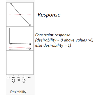

There is a lot of flexibility on how to set up your desirability function (Desirability Profiling and Optimization (jmp.com)), so we can imagine that you may set up the desirability profile of your response and "constraint response" like this :
This way, even if you're not interested in the exact values from response 2 (constraint), creating a desirability function for this response will enable to be sure that this constraint is taken into consideration in the Profiler optimum.
