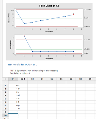

Hello, i'm JMP 17 user. I have one question.
Nelson Rule 3  (Warning-Test3) : 6 data poins in-a-row steadily increasing or decreasing
definition itself is confusing and for other program (Minitab), it doesn't trigger rule 3. if i change last number 0 to 7, then it appears
which one is right?

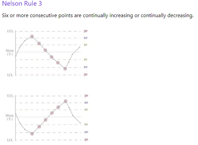

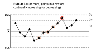

but those two links or many examples in google also make me confused.
Upper picture is mostly used but conflicted with JMP - 1 2 3 4 5 6 7* (6 increment)
Below picutre - 1 2 3 4 5 6* (5 increment). This is same approach with JMP and i thought it is right.
But can i find exact source to prove it is right?

Right. minitab also uses 6 but with different approach
6 points in a row increasing or decreasing
1 2 3 4 5 6* (5 increment) - Out of Trend for JMP
1 2 3 4 5 6 7* (6 increment) - Out of Trend for Minitab
Can i know which one is right based on correct source?
