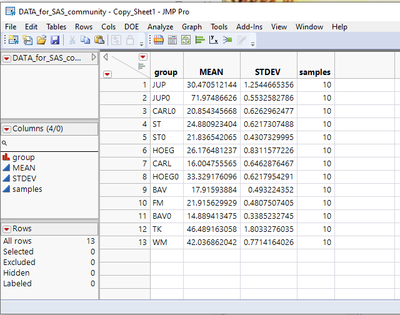

I am currently working on a research project for which i had to calculate some parameters (aka I have their means and standard deviation but not a full table of all repeats). I am trying to do a Tukey HSD test to compare these means and obtain a connective letters report but this seems to be rather impossible (as my table only contains 'one repeat' per measurement/calculation and I do not seem to be able to tell jump that the 2 columns in my data file are already the mean and standard deviation instead of just a random measurement). Does anyone know how to fix this/has a script for this? I am currently working on JMP Pro 16. In the attachment is an example of the datafile

given a data table setup like this:
Where the samples is the sample size of the groups, you can then run the below script

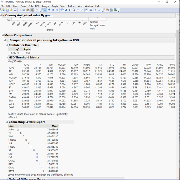

And get the below results

This would indeed be a solution to circumvent the problem. However, due to the simulation, the connective letters report changes from run to run (as you can see in the screenshot below and is expected from a method using this simulation). This still makes it impossible to find the actually significant differences.
