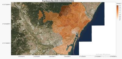

The "Institut Cartogràfic i Geològic de Catalunya" has a public WMS where you can get different layers of the map of Catalonia. With JMP 14 on Windows it connects and downloads the layer, with JMP 9 on Mac it does not.
I attach screenshots made with JMP 14 to verify it.
Translated with www.DeepL.com/Translator (free version)
