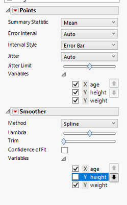

You seem to have to separate columns in Y-axis, like this
In cases like this you can modify Variables on the left side under different graphs, so remove other column from the smoother's variables
(do note that that the colors might get a bit weird as they are order based)

Thank you @jthi :)
