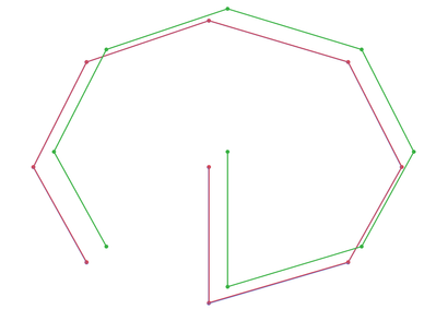

Hi
I am trying to connect data points within a graph in certain order (like creating diamond plot etc.). When I connect manually using line and export the script, I see that it used line function with (X,Y) coordinate. Can anyone please help me with
1. I assume those (X,Y) are frame coordinate?
2. Given 1. is true, How do I find out those (X,Y) using JSL? More specifically, need to know the syntax on how to extract out frame (X,Y) for each data point in the graph?
Any other efficient way you know how to connect data points in JMP?
Thanks much

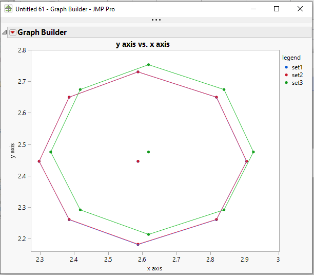

I have adjusted your script a bit, but the main issue is that your code is assuming that you have all combinations of Group1, Group2 and Group3, and in the data you supplied you do not, so the program can not find any data to analyze.
names default to here(1);
dtt = Current Data Table();
Summarize( dtt, byGroup1 = by( :var1 ) );
Summarize( dtt, byGroup2 = by( :var2 ) );
Summarize( dtt, byGroup3 = by( :var3 ) );
For( ii = 1, ii < N Items( byGroup1 ), ii++,
	For( jj = 1, jj < N Items( byGroup2 ), jj++,
		For( kk = 1, kk < N Items( byGroup3 ), kk++,
			dtt << select where( :var1 == byGroup1[ii] & :var2 == byGroup2[jj] & :var3 == byGroup3[kk] );
			show(ii,jj,kk,bygroup1[ii],bygroup2[jj],bygroup3[kk]);
			sel = dtt << get selected rows;
			If( n rows(sel) > 0,
			show("inside",ii,jj,kk);
			dt = dtt << subset( selected rows(1), selected columns(0));
			gb = dt << Graph Builder(
				Size( 531, 456 ),
				Show Control Panel( 0 ),
				Variables( X( :x axis ), Y( :y axis ), Overlay( :legend ) ),
				Elements( Points( X, Y, Legend( 5 ) ) ),
				SendToReport(
					Dispatch(
						"x axis",
						ScaleBox,
						{Format( "Best", 12 ), Min( 2.273568 ), Max( 3.00134902479339 ), Inc( 0.1 ), Minor Ticks( 0 )}
			// Add a simple graphics script to connect the points
			Report( gb )[FrameBox( 1 )] << add graphics script(
				Summarize( dt, byGroup = by( :legend ) );
				colorList = {"Blue", "Red", "Green"};
				Fill Pattern( [0] );
				For( i = 1, i <= N Items( byGroup ), i++,
					Pen Color( colorList[i] );
					theRows = dt << get rows where( :legend == byGroup[i] & :Label != "i" );
		// Add the first value as the last value to complete the object
					theRows = theRows |/ theRows[1];
					xMatrix = :x axis[theRows];
					yMatrix = :y axis[theRows];
					Line( xMatrix, yMatrix );

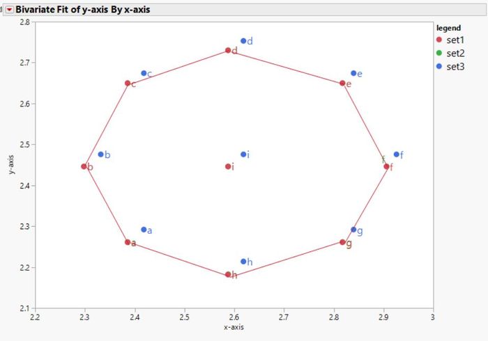

Re: Connecting data points using JSL
Thanks for your input but I was not able to find out what I was looking for. I see different line function and it shows all for a given coordinate. My question was more on how to find those coordinate [frame and not data (x,y)] for a given data point in the graph. I was able to connect using graph builder but then it also connect the center data points which I do not want. If I do exclude then those data points are not shown which also I do not want. I can still replicate the first set of data points to close the diamond but then do not know how I can still show the data points in the center but not connecting it. Thanks much.
here is the data
x-axisy-axislabellegend
2.38562.2608aset1
2.38582.2616aset2
2.41842.2919aset3
2.29792.4459bset1
2.29792.4463bset2
2.33182.4758bset3
2.38562.6498cset1
2.38582.6499cset2
2.41842.6742cset3
2.58752.7302dset1
2.58782.7302dset2
2.61852.7532dset3
2.81742.6498eset1
2.81772.6499eset2
2.83982.6742eset3
2.90592.4459fset1
2.90622.4463fset2
2.92592.4758fset3
2.81742.2608gset1
2.81772.2616gset2
2.83982.2919gset3
2.58752.1817hset1
2.58782.1827hset2
2.61852.2138hset3
2.58752.4459iset1
2.58782.4463iset2
2.61852.4758iset3
I am trying to connect data points for each set but not including "i" group (the center data). sample snapshot is below
Thank you in advance for your help.

If a simple graphics script is added to the Graph Builder object you can get what you want
// Create the data table
dt = New Table( "Example",
	Add Rows( 27 ),
	New Script(
		"Source",
		Data Table( "Untitled 60" ) << Split(
			Split By( :Column 2 ),
			Split( :Column 1 ),
			Sort by Column Property
	New Column( "x axis",
		Numeric,
		"Continuous",
		Set Values(
			[2.3856, 2.3858, 2.4184, 2.2979, 2.2979, 2.3318, 2.3856, 2.3858, 2.4184,
			2.5875, 2.5878, 2.6185, 2.8174, 2.8177, 2.8398, 2.9059, 2.9062, 2.9259,
			2.8174, 2.8177, 2.8398, 2.5875, 2.5878, 2.6185, 2.5875, 2.5878, 2.6185]
	New Column( "y axis",
		Numeric,
		"Continuous",
		Set Values(
			[2.2608, 2.2616, 2.2919, 2.4459, 2.4463, 2.4758, 2.6498, 2.6499, 2.6742,
			2.7302, 2.7302, 2.7532, 2.6498, 2.6499, 2.6742, 2.4459, 2.4463, 2.4758,
			2.2608, 2.2616, 2.2919, 2.1817, 2.1827, 2.2138, 2.4459, 2.4463, 2.4758]
	New Column( "label",
		Character,
		"Nominal",
		Set Values(
			{"a", "a", "a", "b", "b", "b", "c", "c", "c", "d", "d", "d", "e", "e",
			"e", "f", "f", "f", "g", "g", "g", "h", "h", "h", "i", "i", "i"}
	New Column( "legend",
		Character,
		"Nominal",
		Set Values(
			{"set1", "set2", "set3", "set1", "set2", "set3", "set1", "set2", "set3",
			"set1", "set2", "set3", "set1", "set2", "set3", "set1", "set2", "set3"}
// Draw the scatterplot
	Size( 531, 456 ),
	SendToReport(
		Dispatch(
			"x axis",
			ScaleBox,
	colorList = {"Blue","Red","Green"};
	fill pattern( [0] );
		Pen Color(colorList[i]);
		line( xMatrix, yMatrix );
Jim

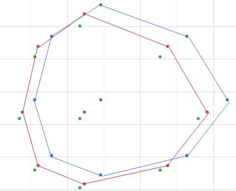

Thank you so very much for the help. Greatly appreciate it. I have one more question and will be thankful if you please help.
I have a large table consisting of many of the subset (the table I sent you) and controlled by three more additional column. I was trying to create subset of tables(each like the one I sent you) and apply the code below within three For loop. Somehow the subset table generation is not working.
            dt = dtt << subset(
                Size( 531, 456 ),
                SendToReport(
                    Dispatch(
                        "x axis",
                        ScaleBox,
                        Minor Ticks( 0 )}

txnelson
				Size( 531, 456 ),
				SendToReport(
					Dispatch(
						"x axis",
						ScaleBox,
