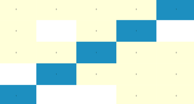

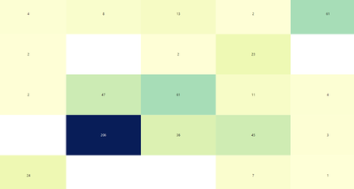

I'm working on a confusion matrix using the graph builder. I have 2 columns one is Known class (y-axis) an the other Predicted class (x-axis). I want the numbers inside the boxes to show the number of samples in each box. As shown in picture below.
However, instead of the colour gradient map, I would like to have the main diagonal (True Positives) be one colour and the rest of the boxes a different colour. I have a column that is either 1 or 0 depending on whether the sample is a True Positive or not, however when I add this column to the colour option in Graph Builder this happens:
Is there a way I can have the colours as in the second picture, but the labels of the first picture?

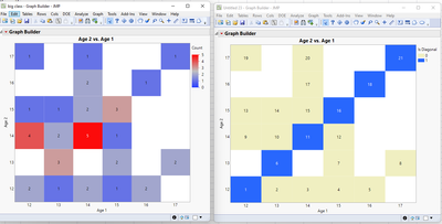

Re: Confusion matrix colour and count based on different variables
Thank you for your answer but I don't think this gives the right solution, see below:
Left shows the actual values that should be displayed, right is what the script provided results in.

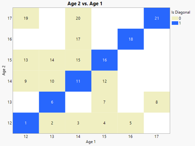

Sorry about that, I missed saving that step.  Again here I summarized the table first and then drew the graph using row labels instead of the counts, but this time I actually defined row labels:

dtSum << New Column("Is Diagonal", Numeric, "Nominal", Format("Best", 12), Formula(:Age 1 == :Age 2));
dtSum:N << Label( 1 );
gb = dtSum << Graph Builder(
