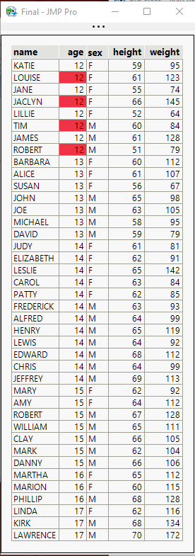

Thank you Jim. This is working now. However, now I have run into another issue. I want this color coded data table to be a part of a report/final journal along with other graphs below this table. Something like below. When I try to use data table box to add this table to the report, the color coding disappears and there are no border/grid lines. Can you please help me with code to achieve the following layout?

The only way that I have been able to get a copy of a data table that has color in the cells to be moved into a journal, is to first to put the data table into a window by itself, and then to append the temporary window with the data table in it, to where ever it needs to be in the final journal.  See the example script below
Names Default To Here( 1 );
dt = Open( "$SAMPLE_DATA/big class.jmp" );
:age << color cells( "red", [2, 4, 6, 8] );
temp = New Window( "temp", <<journal );
dt << journal;
temp[Table Box( 1 )] << set row borders( 1 ) << set column borders( 1 );
nw = New Window( "Final",
	bb = Border Box( sides( 15 ), top( 5 ), bottom( 5 ), Left( 5 ),
		Right( 5 )
bb << append( temp );
temp << close window;
Jim
