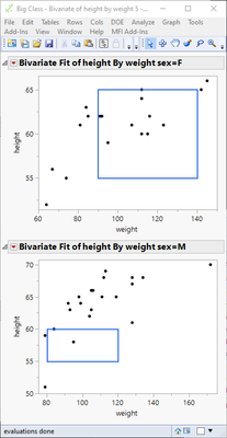

As you can see above, I am grouping the dataset by the column :Checker Name. However, I wanted to extend this script by also adding transparent Rect() graphics objects to create acceptable ranges to each of the scatterplots. However, the dimensions and location of these Rect() objects will vary depending on which bivariate plot it is being plotted in. In short, I need to create a key of :Checker Name to Rect sizing variables that will be correctly applied depending on the bivariate plot in the set. Is this something easy/plausible to incorporate in the pre-generated script I have above?

I assume you are using JMP18. When you use By you get a list of platforms back and you can then loop over that. Then it is just about figuring out how to get the title and so on (or you can use Summarize and in that case I would build the reference list in a bit different way). If it is difficult to figure out the looping, you can first just create single bivariate platform and get it working, then expand to loops
Names Default To Here(1);
aa_rect = Associative Array();
aa_rect["M"] = Expr(Rect(80, 60, 120, 55));
aa_rect["F"] = Expr(Rect(90, 65, 140, 55));
bivs = dt << Bivariate(Y(:height), X(:weight), By(:sex));
For Each({cur_biv}, bivs,
	ob = Report(cur_biv)[OutlineBox(1)];
	obtitle = ob << get title;
	show(obtitle);
	category = Word(-1, obtitle, "=");
	fb = ob[FrameBox(1)];
	Eval(EvalExpr(
		fb << Add Graphics Script(
			Pen Color("Blue");
			Pen Size(2);
			Expr(aa_rect[category]);
-Jarmo

I'm considering using an associative array to assign a rect object to each possible key in the Checker Name column. Can you provide an example of iterating over a list of outline boxes and adding a rect() object to each one? I am also unfamiliar with the Summarize function.
jthi
Re: Conditional Bivariate Fit Customization Script Based on Group By Column
	show(obtitle);
	Eval(EvalExpr(
			Pen Color("Blue");
			Pen Size(2);
-Jarmo
