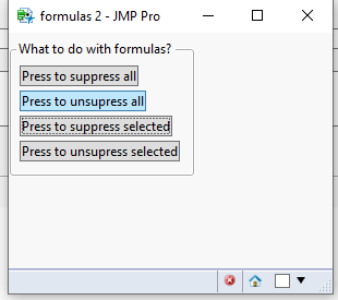

Way to move a window into a "child" poistion on the home window?
Hey everyone,
I was wondering if there was a way to script in moving a "New Window" as a "child" of the data table, like a normal analysis widow shows up as:
I'd like this window to show up under the data table it is working with
So under the graph builder icon.
Thoughts?
Steve
