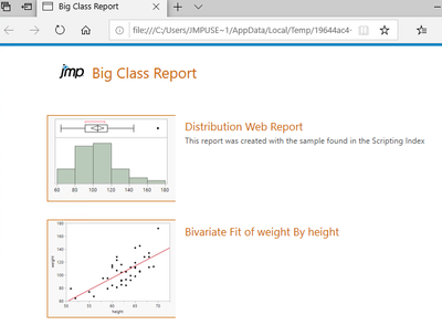

I've run a continuous script & save 6 charts as individual file (.html).
How do I combined my 6 html files into 1 web report (something like this JMP sample)?
I checked the scripting index, it gives below script but my script and data table change to generate the 6 charts & files.
So, when I tried to fit in below script into my script, the charts did not show correctly as I wanted to.

Any suggestion or simple way to do it?
I'm using JMP 15 & attached herewith the JSL script

My suggestion is that you create a journal window at the beginning of your script, and then rather than saving each output as interactive html, that you copy the output to te journal window.  Then at the end of the script, you save the whole journal to interactive html.
Jim
