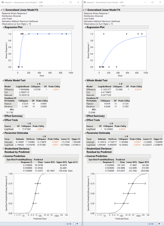

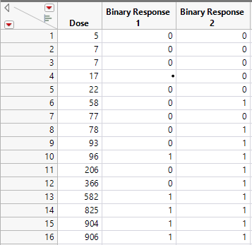

I have a dataset where a group has been exposed to different doses of a compound, and two different endpoints of interest (both binary responses) were measured (data table is below and .jmp file with dataset is attached).  I have run individual dose-response analyses on each to estimate the ED50 (log-probit fit using GLM).  I would also like to compare the dose response curves, but am not sure of the best way to approach this since the two endpoints are in the same population.  Any guidance would be greatly appreciated.

Sorry for the delayed response.  In general, I would like to know if it is possible to say statistically if different dose response models best describe the data.  If different models are best to describe data, I would like to be able to compare specific parameters such as the ED50 and possibly the slope.

Sorry for the confusion.  I did not mean two separate model types - I would like to use a log-probit to fit the dose-response data for each response type.
What I want to know is if the dose-response fits for the two responses are different from one another - i.e. is the ED50 for the first response lower than that for the other response?  I thought about putting response in as a dummy variable, but wasn't sure if this was correct since the responses are paired in the same population.

I think that the simplest way is to introduce a Curve variable and cross it with the other terms in the model. For example, if the linear predictor of my model is B0 + B1 + B1^2, I would expand it with terms to this form B0 + Curve + B1 + B1^2 + Curve*B1 + Curve*B1^s. The effect tests will tell you if the estimates depend on the curve. If the estimates of the new terms are not significant, then there is no such difference in the curves.
Re: Comparison of dose-response curves for different endpoints within the same group
I am still confused, after all. My previous answer is about comparing the curves (i.e., models), but you want to know if the inverse prediction (e.g., ED50) is different
Ultimately comparing the inverse predictions is what I am interested in, but I would also like to know how to compare the curves.  Your previous reply was helpful in that regard.
