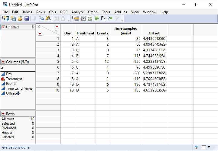

This appears to be a classic case for a Poisson log-linear regression. JMP provides it through a generalized linear model (GLM). You model the count of events directly. I copied your data into a JMP data table.
The time of observation varied for each treatment. This variation is known as 'opportunity' and is modeled with an offset. The offset is the log( opportunity).

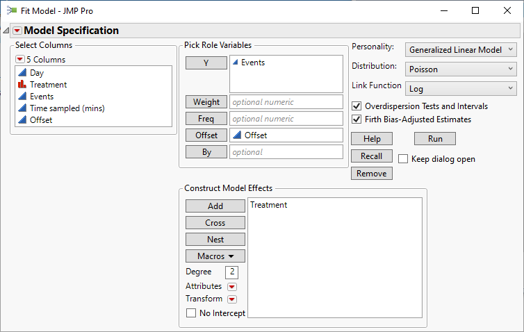

Then select Analyze > Fit Model and change the launch dialog to look like this one.

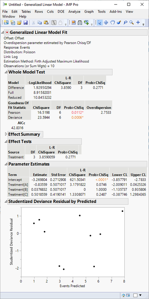

Here are the results of the regression.
The effect of the treatments is not significant at alpha = 0.05 (Whole Model Test and Effect Tests). The 'over-dispersion' is significant, meaning that the variance is greater than expected for a Poisson distribution of the response. The deviance is also significant, which indicates lack of fit. There could be lurking variables that were changing along with the treatments.

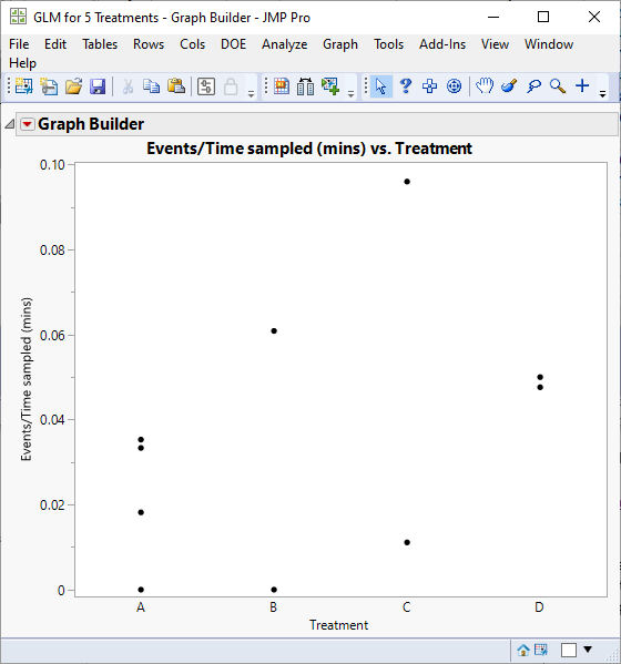

Similarly, a scatter plot of the event per time versus treatment does not exhibit a clear effect.
