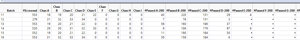

I have a table consisting of batch number of devices, columns of Bin # and number of devices in this bin.
For example for batch #11: bin 18 has 43 devices, bin 19 has 223 devices...

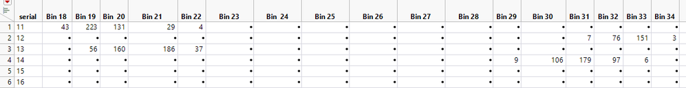

Is there a way to transform that table to have columns name as bin# and cell values as number of devices in that bin.

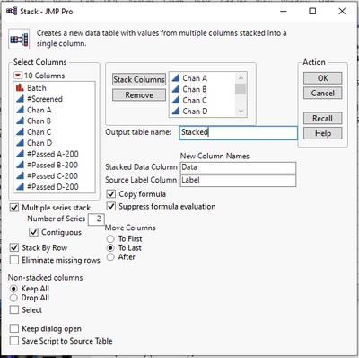

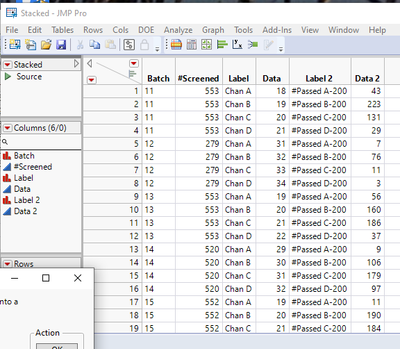

I think the solution is to first stack the 2 groups of columns, and then to split the columns by the stacked bin values.
My Sample data table......your data, just only 4 Chan and 4 #Passed columns
Go to
     Tables=>Stack
and perform a Multiple series stack
It creates a table that looks like:

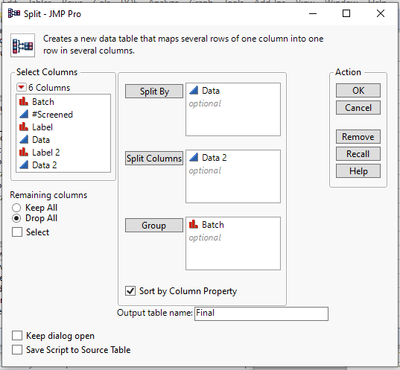

Now go to
     Tables=>Split
and split the data based upon the column called Data that has the Bin values
It produces the following table which I believe is what you want, minus the exact names for the columns
Here is the steps to do the above in a script,
names default to here(1);
dt = Open("Example.jmp");
// → Data Table( "Example" )
Data Table( "Example" ) << Stack(
	columns(
		:Chan A, :Chan B, :Chan C, :Chan D, :"#Passed A-200"n, :"#Passed B-200"n,
		:"#Passed C-200"n, :"#Passed D-200"n
	Source Label Column( "Label" ),
	Stacked Data Column( "Data" ),
	Number of Series( 2 ),
	Contiguous,
	Output Table("Stacked")
// Split data table
// → Data Table( "Untitled 17" )
Data Table( "Stacked" ) << Split(
	Split By( :Data ),
	Split( :Data 2 ),
	Group( :Batch ),
	Remaining Columns( Drop All ),
	Sort by Column Property,
	Output Table( "Final")

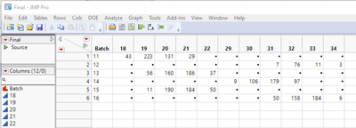

Jim

txnelson
Re: JSL - table transformation
Go to the pull down menu
     Tables=>Transpose
Jim

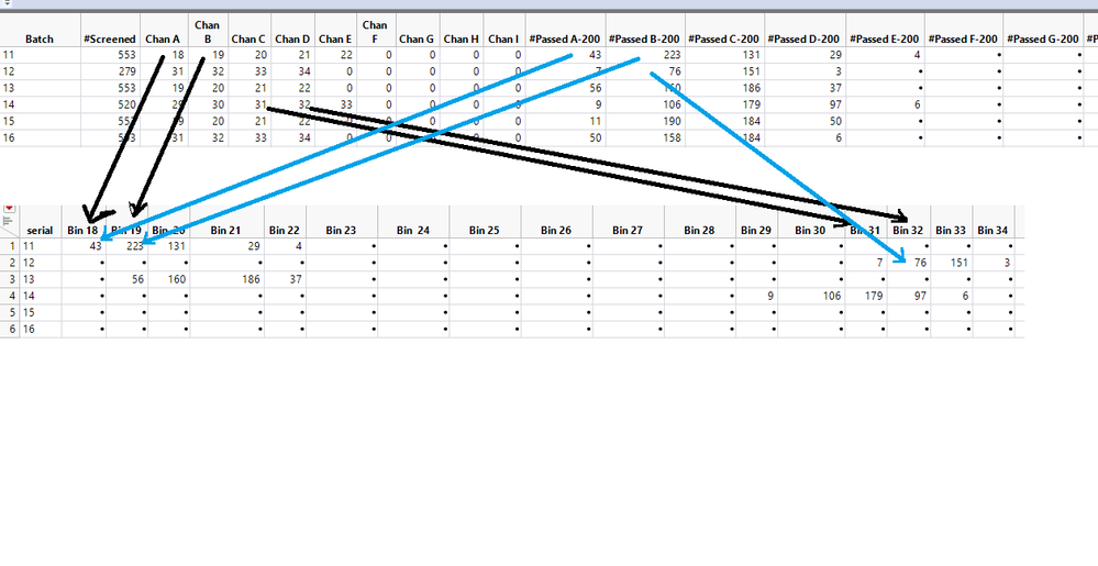

Trying to explain better my problem:
I created new columns with names Bin 18, Bin 19, Bin 20... I need to fill corresponding columns with values from columns "# Passed X-200".
So for batch 11 columns Bin 18, Bin 19, Bin 20, Bin 21, Bin 22 with 43, 223, 131, 29, 4 respectively.
Go to
     Tables=>Stack
Now go to
     Tables=>Split
