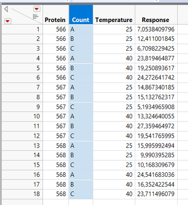

In order to compare your data from two different tables, you will need to combine these two datasets in a stacked format, like this :

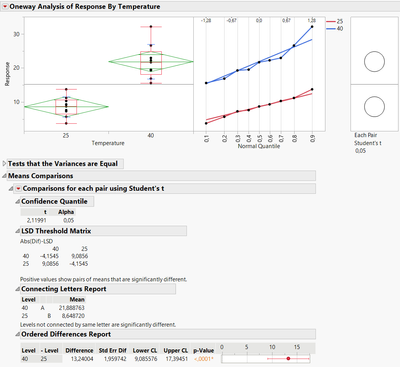

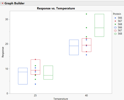

Then, using Graph Builder, you can plot your data using your Response in Y axis, and the Temperature as X axis, and the Protein ID as the Overlay variable. Using a local data filter may help to avoid too much different data and lines of fit (or box plots if temperature has a nominal data type) for different proteins.
If you're interested in analyzing your data, you can use the Platform Fit Y by X : Oneway Analysis (jmp.com)
However, since you only have 3 values for each protein and for each temperature, this seems to be a very low sample size to run any statistical tests.
I would recommend plotting your data individually by proteins, to check for patterns, and (with caution) analyzing the whole dataset with the platform Fit Y by X, to see if you have a general trend that may be statistically significant for the change in response depending on temperature. Please check that your data do respect the assumptions of the test you want to use (variance homogeneity, normality of the distribution and independant observation for parametric test) :

I attached the example datatable so that you can see these different options.

The "By" box in the Fit Y by X platform instructs JMP to do a different analysis for each value in the By box.  What I think you want is for the By variable to be Temperature.  If so, make sure it is nominal (so there are two groups rather than a continuous scale) and put Temperature in the X box of the platform.  Don't put anything in the By box.
