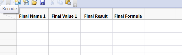

@uday_guntupalli I am really sorry about that. My table looks similar to this:
The list I have is list = {Name, Value, Result, Formula}
I have about 65 columns and the list contains about 30 names.

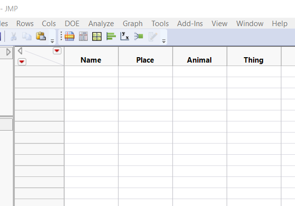

        Let us say your table looks like what is shown below.
     You can use the following piece of code to update the column names by appending "Final" or any other word as shown below. You were on the right track, the only thing you needed to add was, getting a reference for the column and add a set name command
dt = current data table();
ColNames = dt << Get Column Names("String");
for(i = 1, i <= N Items(ColNames), i++,
		Col = Column(dt,i); // get reference for column
		Col << Set Name("Final " || ColNames[i]);
