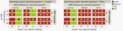

For data import, I created an overview which data can be imported and which import fails:
txt import - point and comma ?
In Excel, users can specify the decimal separator in the Import window's GUI.
For each import, the user can select the correct setting, regardless of their preferences or system settings.
Why is there no such setting in JMP?
Make decimal separator an option
