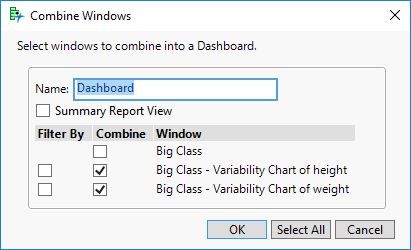

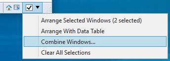

Jim's answer is correct, of course, for you specific question. But did you know that you do not need a script to achieve this result?
With the three Variability Chart platforms open, click the check box in the lower right corner of each platform. They should look like this:
Now click the black triangle in the same corner and select Combine Windows.
You are given some more choices:
You are done when you click OK if this dashboard is a one-time thing but if you want to re-use it in the future, click the top left red triangle next to Report:
This feature is fully described in Help > Books > Using JMP.
