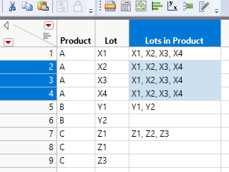

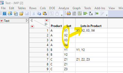

Hello,
I am trying to do the following:
Given Product Column and Lot Column, I need to create "Lots in Product" Column so that it combines all the "lots' based on the same product.
The final purpose is to get the Tabulate:
The X1, X2, X3, X4 does not have to be present in the single cell, this will work as well (whichever is easier):
Manually this process is insane when I have a table of thousands of datapoints.
Thank you so much!
JMP table is attached.
Alex.
