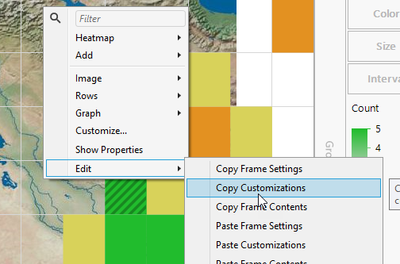

When I add an Image to Graph Builder, why do I lose the possibility to edit the Hover label?

Workaround for user without JSL experience - for lazy ones - and for users who want to edit the hover label settings inside a complicated Dashboard:
- Copy Customizations
- delete the image
- adjust the hover label
- Paste Customizations
- delete the image

Most likely a bug/oversight and should be reported to JMP Support (and not to JMP Community).
Maybe there could be some weird location where you could access the hover label menu without removing the image / using JSL, but I couldn't quickly figure out where it could potentially be (if there is one).
