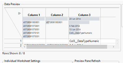

Data preview looks very weird when you tell JMP that there are no headers (columns 1 and 2 have missing values)
-Jarmo

Thanks for the help. I didn't realized that no column headers are so important. I do of course have column header (Sample, Vendor and Date). But I'm struggeling with the 2 data types in a column. If there is a number in the first row, JMP set the data type to numeric and deletes the rest of the rows. Does that mean I have to wait for JMP 18 and can't do anything about it?
