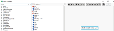

dt << New Column("Gort", formula(column(a)*:Y));
When I use this however, it does not see "klaatu barada nikto" as a valid column, even though we created it before.
From other posts I have seen that the column() function can be used to assign a string to a column and I have used it in this way before, but in this instance it does not work. All we end up with is this:
Does anyone know a workaround for this? Thanks for any help in advance!
