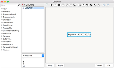

Hi,
I have a table of data containing several hundred rows and need to create a column that is filled with incremental numeric values, the twist is that I require the incremental fill to follow as below:  The column is called "sample" and row 1 value = 1, row 2 value = 1, then increment by 1, so that row 3 value = 2, row 4 value = 2 and continue to the end of the data file.
 sample
 1
 1
 2
2
 3
 3
 4
 4
 5
Any thoughts?

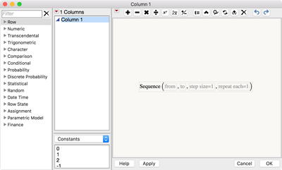

Re: Column filling
Try the Sequence() function.

Jeff_Perkinson
Re: Column filling
-Jeff
Onjai
Level IV
Re: Column filling
Jeff,
Thank you.  Sequence worked perfectly.
