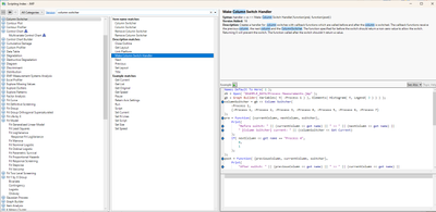

Looks like the column switch handler was not added until JMP 16.

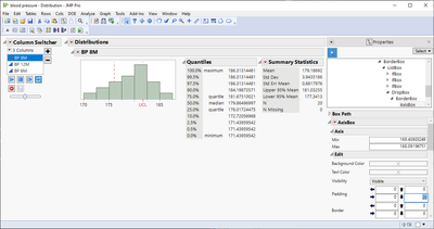

Here is a script that gets you partially there.  For some reason, it removes the Axis values, but if you can try it on your data, you might be able to figure out how to get it to work correctly.  The code was developed using JMP 14
names default to here(1);
dt = open("$SAMPLE_DATA/blood pressure.jmp");
has_limits = {"bp 8m", "bp 12m", "bp 6m"};
for(i=1,i<=nitems(has_limits),i++,
	new column(has_limits[i] || "_UCL", values(matrix(quantile(.75,column(has_limits[i])<<get values))));
	new column(has_limits[i] || "_LCL", values(matrix(quantile(.25,column(has_limits[i])<<get values))));
dist = dt << Distribution(
	Continuous Distribution(
		Column( "bp 8m" ),
		Horizontal Layout( 1 ),
		Always use column properties( 1 ),
		Vertical( 0 ),
		Outlier Box Plot( 0 )
	Column Switcher( "item 1", has_limits )
report(dist)[framebox(1)]<<add graphics script(
	try(report(dist)[axisbox(1)] << remove Ref Line( tempUCL));
	tempUCL = column(report(dist)["Distributions",OutlineBox(2)] << get title || "_UCL")[1];
	report(dist)[axisbox(1)] << Add Ref Line( tempUCL, "Dashed", "Medium Dark Red", "UCL", 1 );
	try(report(dist)[axisbox(1)] << remove Ref Line( tempLCL));
	tempLCL = column(report(dist)["Distributions",OutlineBox(2)] << get title || "_LCL")[1];
	report(dist)[axisbox(1)] << Add Ref Line( tempLCL, "Dashed", "Medium Dark Red", "LCL", 1 );

Thanks for this. I haven't figured out the missing axis values yet, it's very strange (also shows a "loading" cursor) but it's at least a step in the right direction.

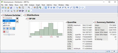

A work around might be to run your JSL, and then go to the Red Triangle in the report output window, and select Save Script.  Save it to a script window and then run the script.  My testing shows that the code that JMP creates has the missing X Azis Labels.
I have submitted the bug to JMP Support.
Jim
jthi
Super User
Re: Column Switcher - Dynamically Add/Remove Reference Lines
Other workaround that seems to work is to add padding (maybe something is being pushed on top of axisbox?)
or enable Tick Marks inside Graph Frame from axis settings, though this makes the graph a bit weird looking and I think you might want to also enable grid lines
