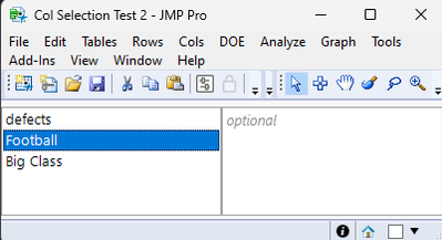

When I select 'defects' I get the following which is the desired result
However, subsequent selections of the other tables do not populate the columns

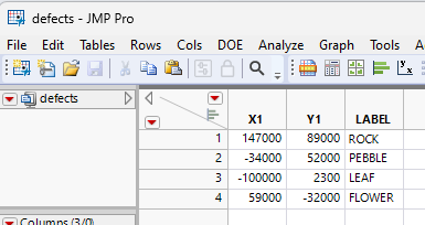

defects.jmp table

Re: Column Selection issue
You will have to replace Col List Box as it will refer to specific data table
