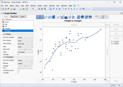

You can use the Column() function to reference column names in your "cnmes" list of column names.  Or if you are hard coding the column names, using the following
// Report snapshot: Big Class - Graph Builder
Data Table( "Big Class" ) << Graph Builder(
	Variables( X( :"1height"n ), Y( :"1height"n ) ),
	Elements( Points( X, Y, Legend( 6 ) ), Smoother( X, Y, Legend( 7 ) ) )
names default to here(1);
dt =
// Open Data Table: Big Class.jmp
// → Data Table( "Big Class" )
Open( "$SAMPLE_DATA/Big Class.jmp" );
// Change column name: height → 1height
try(Data Table( "Big Class" ):height << Set Name( "1height" ));
// Change column name: weight → 3weight
try(Data Table( "Big Class" ):weight << Set Name( "3weight" ));
cnmes = dt << get column names( "string" );
Graph Builder(
	Variables( X( column(cnmes[5])), Y(  column(cnmes[4]) ) ),
Jim
