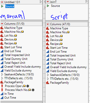

Hi,
I want to join 2 data tables into 1 merge data table using scripting.
I already joint the 2 data tables into 1 joint data table manually, so I copied the same script from the joint data table into my master script.
Somehow, when I run the master script, all the chosen columns from dt2 not included in the joint data table.
Why it is not working?

Hello! If you look at the documentation for the Join function (here) it states that "when you use Update main table with data from second tableSelect Columns for joined table is not applicable." So it will just look to update the existing columns you have in the main table. Try either not selecting that Update command or using the separate Tables > Update tool to try and accomplish your goal.

Thanks a lot. After I did not select that update command but continue from the 2nd table, it works.
