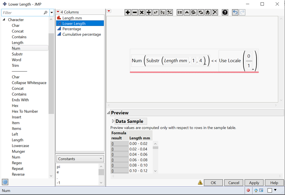

Hi Jarmo,
Do you mean like this?

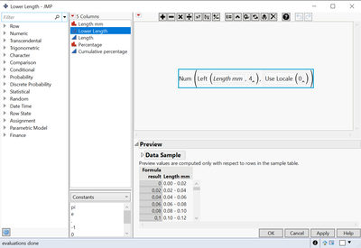

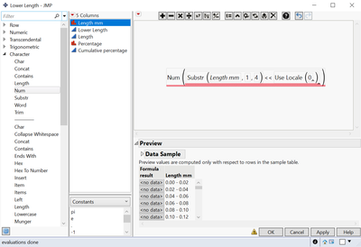

Re: Colum formula result error
Yes, my decimal separator is a comma.
The problem was only solved when using the Left function. Do you know why the Substr function didn't work?
I will post the outcomes below from other formulas I tried, just to document what worked and didn't worked for me.
I hope this helps others as well.
jthi
I would think Substr(x, 1, 4) works exactly the same as Left(x, 4) so my guess is that in your formula, with Substr, you are just missing comma after Substr
Num(Substr("0.01 - 0.02", 1, 4), << Use Locale(0))
-Jarmo
deboraam
Level II
You're right... including comma worked as well.

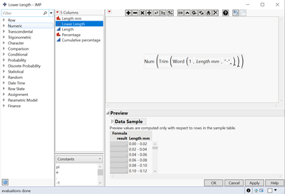

txnelson
1.  Try displaying Length MM using a Hex format to see if there are any hidden special characters in your data.
2.  I normally use the Word() function rather than Substr() in cases like this.
num( trim( word( 1, :length mm, "-") );
Jim
deboraam
Level II
I tried to change the display in the "Length mm" column, as you suggested, but I couldn't find the Hex format among the format options. Anyway, I tried your formula to see if it worked, but it didn't.
It ended up working only with the formula suggested by @jthi.
